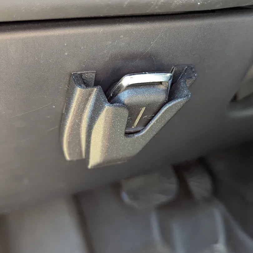

    Vielleicht hilft ja dieses Zubehör:
    Fisker Ocean Keyfob Key Card Mount – NFC Connectivity Fix
    Fix your Fisker Ocean's "no key detected" error with this 3D printed NFC key card mount. Easy install, no tools needed. Ships worldwide from the Netherlands
    yurikaccessories.com
